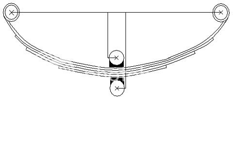

Heres a rough sketch of an SOA vs SUA ... of course its not to scale which gives it a rather wierd interpretive look.
Hopefully this is a better perspective ...
